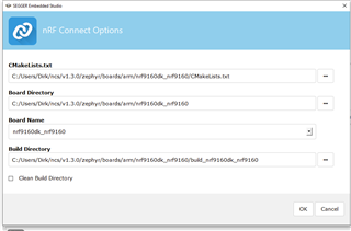

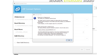

I have installed the latest SDK 1.3.0 using the Toolchain Manager.
I would now like to open nRF Connect SDK Projekt and get the follwoing error:
I have added the CXX environment variable, but it did not help

The "CMakeLists.txt" field should point to the CMakeLists.txt of your project, not the board.
E.g. if you want to build the asset_tracker project, the path should be <your NCS folder>/nrf/applications/asset_tracker/CMakeLists.txt.
In addition, if you want to use the modem in the nRF9160, you must build your application as non-secure. To do that, you must select the non-secure version of the board.
I.e. nrf9160dk_nrf9160ns (notice the "ns" at the end).
Finally, in case you are not already doing it, when you install NCS using the Toolchain Manager, you must open SES (or bash/cmd) from the Toolchain Manager for the environment to be configured correctly.

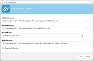

thank you for your swift reply and help. now I can build the asset tracker and even the lwm2m_client which will be the base for our application.
Later yesterday the toolchain manager downloaded SDK 1.3.1, but it seems incomplete. When I select the lwm2m_client in the 1.3.1 folder the build process fails again:
For the time being I will continue with lwm2m_client from the 1.3.0 folder which works. Just to let you know there is a problem with 1.3.1.

I notice that you are still using the board folder from NCS v1.3.0.
Could you try to change that to 1.3.1 as well, and see if that helps?
The zephyr map for the 1.3.1 has no boards subdirectory. It only contains module.yml. That is the reason I tried to use the old board directory.

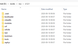

That does not seem right.
The v1.3.1 folder should look like this:

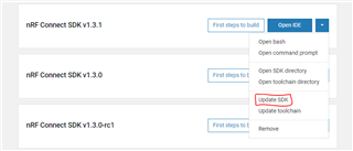

Can you try to "Update SDK"?
If that does not work, you can try to "Open bash", and run "west update"?
If you get any errors, please send them to me.

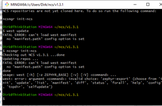

Hi Didrik,
I have tried Update SDK for 1.3.1 from Toolchain Manager without success. I have tried from BASH west update and also ncsmgr init-ncs but I get errors:
