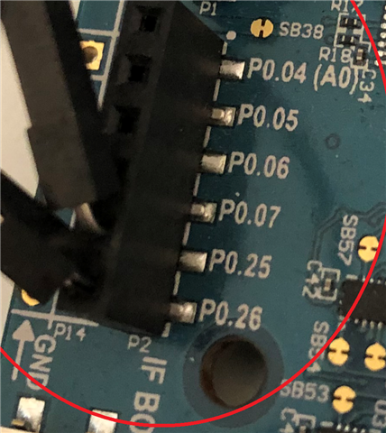

  • Another thing I wanted to clarify by using the custom binding of the sample as an example, is this line:
    Fullscreen
    1
    io-channels = <&adc 0>, <&adc 1>;
    XXXXXXXXXXXXXXXXXXXXXXXXXXXXXXXXXXXXXXXXXXXXXXXXXX
    As you can see, the io-channels are ´[&adc 0]´ and ´[&adc 1]´ which maps the ADC peripheral to channel 0 and 1. This just maps the ADC node to the analog input of channel 0 and the analog input of channel 1, which is AIN1 and AIN2, which then maps to GPIO pin P0.04 and P0.05 on the PDK, according to this table describing the mapping of analog pins on the nRF5340 PDK.
    According to the PCA10095 schematics of the nRF5340 PDK  (nRF5340-QKAA) pin 4 on P0.04 is AIN0 not AIN1.
    I have already raised this issue with Martin Lesund about three weeks ago and he said he will get this corrected. There seems to be some discrepancy between the user guide and the schematics. The latter is correct.
    So, this means channel_id = 0 i.e. index zero into the channel array points to AIN0.
    Kind regards
    Mohamed

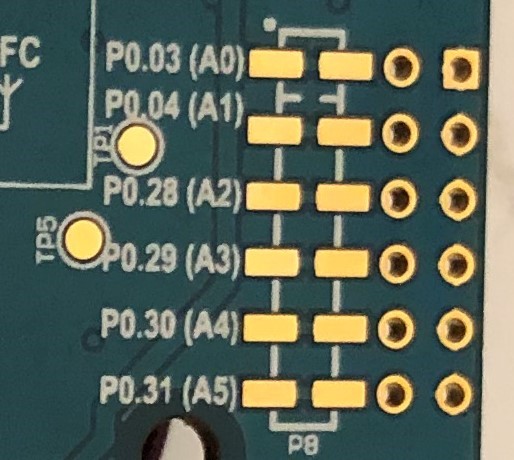

  • So, this means channel_id = 0 i.e. index zero into the channel array points to AIN0.
    Since it seems we have the channel_id index offset by one in the nRF5340PDK, does it mean the examples referred to will not work as expected?
    According to the PCA10095_schematics of the nRF5340PDK pin P0.28 is AIN7. So, I connected a potentiometer to pins: P0.28, VDD, GND and tried to run the light intensity controller example but the adc did not work with this configuration code.
    #define ADC_1ST_CHANNEL_ID 7
    #define ADC_1ST_CHANNEL_INPUT NRF_SAADC_INPUT_AIN7
    So, I looked closely to pin P0.28 on the back of the pdk board and realised that P0.28 is actually labelled (A2). So, I changed the config to,
    #define ADC_1ST_CHANNEL_ID 2
    #define ADC_1ST_CHANNEL_INPUT NRF_SAADC_INPUT_AIN2
    and Bingo! it works. So, it seems that for the nRF5340PDK the values used for ADC_1ST_CHANNEL_ID  and ADC_1ST_CHANNEL_INPUT must the same. Any comments?
    Kind regards
    Mohamed
  • Hi!
    You know what, I misunderstood the description of channel_id. Sorry about that.
    At a closer look: "This value primarily identifies the channel within the ADC API". So the value of the channel_id does not matter (in the range of 0 to 7) as long as it is used consistently to identify that channel. This explains why channel ID 0 is used for AIN0 and channel 2 is used for AIN2, here.
    My mistake, sorry for the confusion! There is no channel id offset and the sample should work as expected.
    Yes, the table I linked to is apparently incorrect, so this is the correct pin mapping.
    AIN0 P0.04
    AIN1 P0.05
    AIN2 P0.06
    AIN3 P0.07
    AIN4 P0.25
    AIN5 P0.26
    AIN6 P0.27
    AIN7 P0.28

    So according to the analog inputs and channels page for the nRF5340, there are eight analog input channels that can be configured CH[n] (n=0, 1, .., 7).
    There are also eight analog inputs available (AIN0, AIN1, ... AIN7) and VDD and VDDHDIV5.
    So the channel_id refers to one of the eight analog input channels and the channel_input refers to an analog input. That is the difference.
    There are 8 identical analog input channels and you can use whichever one you want and you can configure that channel with any analog input you want. They are not "connected" as I initially thought, where channel 0 uses AIN0 and so forth.
    If it helps you understand better, here is how the channel_id is used in the code.
    So the function adc_nrfx_channel_setup(const struct device *dev, const struct adc_channel_cfg *channel_cfg)
    is called, where channel_id is one of the properties in the adc_channel_cfg struct.
    Then, in this function, the channel_id is passed to nrf_saadc_channel_init(), here. If you take a look at the function definition, you can see the channel ID is being used the select the correct CH[n].CONFIG register to add all the configurations.
    p_reg->CH[channel].CONFIG =
    The positive input isn't set until the start_read() function is called. Then the function nrf_saadc_channel_pos_input_set() is called here. If we take a look at this function definition:
     No, they do not need to be the same. You do however need to be connected to the correct GPIO pin.
     Those labels are just the arduino naming and don't correspond to the analog inputs.
    It also looks like the printing on back of the board and the front of the board don't match up.
    The front of the board has the correct labeling, so if you are plugged into the pin with the P0.08 label on the back, you are actually connected to P0.06 which is AIN2. So at least that mystery is solved!
    Also, on the nRF5340 PDK GPIO P0.28 (AIN7) is also used for LED1. To be able to use AIN7, you will need to cut SB5 on the board, see here.
