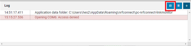

  • What state are the LEDs in when you try to add the device to the website?
    Can you open up LTE Link Monitor in nRF Connect for Desktop and take a look at the output log from the device?
    Press this button to retrieve the log as a text file and attach it in your next comment.

  • No. Please let it run for more than 10 seconds.
    Also do not copy and paste any logging information in a comment.
    Press the button I showed in my previous comment, save the file as a .txt file and attach it in your next comment (Insert -> Image/video/file -> Upload -> Ok).
