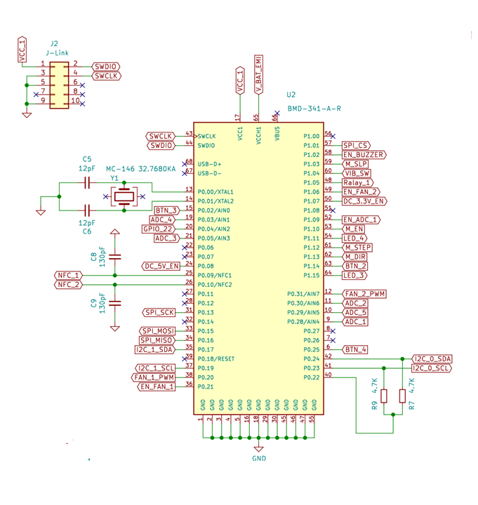

We have a custom PCB fitted with the nRF52840 SOC, we've previously erased and written to it via the nRF programmer tool. However, when trying to use the nrfjprog -e command it erases the board successfully but any subsequent attempts to reach the board (nrfjprog -e, nrfjprog --recover, or any command) produce the following error:

  • We're using the Segger Jlink to communicate with the board via SWCLK and SWDIO, it is also feeding VCC but the board's power is dependent on a LiPo 3.7V battery via ADC.

    My initial suspicion is that your design is not using the default output value of REG0 which is 1.8V. A nrfjprog --eraseall command will erase everything from the IC including the UICR. The UICR contains the REG0 register which sets the output of the first regulator. Are you using the board in High voltage mode and have you configured REG0 to something else then the default value?
    regards
    Jared
  • Your suspicion is spot on. We did set the board in High voltage mode prior to using erase. We set REG0 with the command:
    nrfjprog --memwr 0x10001304 (UICR.REGOUT0 address) --val 0xFFFFFFFD (3V3 setting)

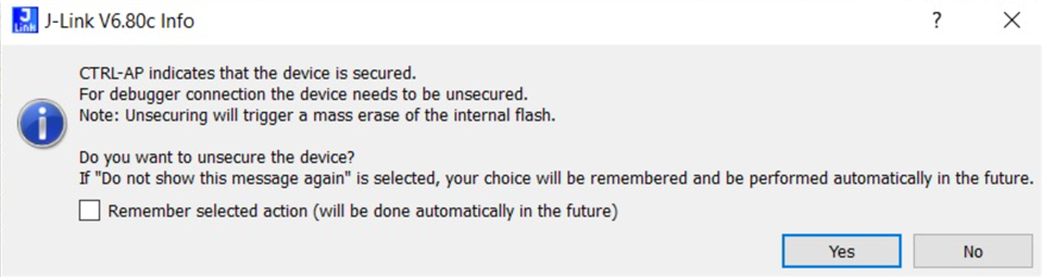

    We noticed that when trying to compile via Segger Studio, we get the following message (If we accept it just carries on to give the "no idcode..." error) :
  • aha, seems like you're also using the APPROTECT feature. The APPROTECT feature secures the IC from any external read, erase, or write operation after it has been activated. It does this by disabling the debugging interface. The only way the device can be recovered after the APPROTECT has been activated is by issuing a nrfjprog --recover command. Note that this will erase everything on the chip and set it back to default mode.
