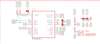

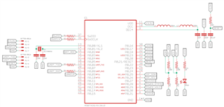

Twi_scanner has fallen into an infinite loop.
Hello
I am working on SDK v17, using nRF52832 (MDBT42Q) and MPU6050 sensor.
I tried TWI_SCANNER because I thought there was a problem getting the value of MPU6050.
However, if I proceed with the scan on this board, I will not be able to escape from 'nrf_twim_event_check' and will have an infinite loop.
This is my main code and modified PCA10040 code.

Testing with the NRF52DK board will work normally. Is there a possible hardware problem?
Can I know the cause and solution of this problem?
Thank you.
In nRF52DK, there is the same problem if I connect the SCL, SDA pin to 26,25 and debug it. Is this a problem with the nrf52832 pin? Should I redesign my hardware?
Thank you.

    Did you check what is returned by the application from the function call when it's not a success and it's running on the custom board?
    schosdas said:
    I got another nRF52DK board and tested it.
    This board works perfectly on the same pin and same code...
     This might indicate that your old DK is not functional.. Anyways, I think we should focus on the custom board on this ticket. You can open a new ticket regarding the different behavior between your old DK and the new one.
    regards
    Jared
