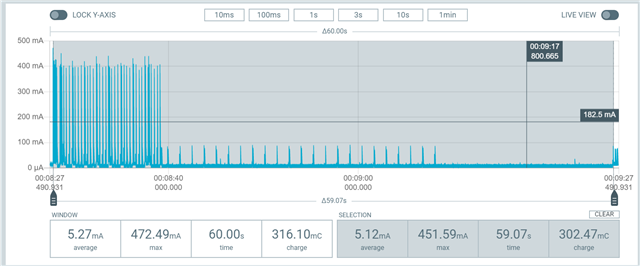

Above is the power profile for a complete cycle

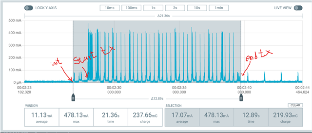

  • 1. I power profiled the consumption of the nRF9160 custom board and DK too separately (PPK2) and notice that every MQTT Tx shows peaks with about 12s to 13s duration ? is this normal? Why do the peaks take so long even though the data is received within the first 2 seconds by my broker?

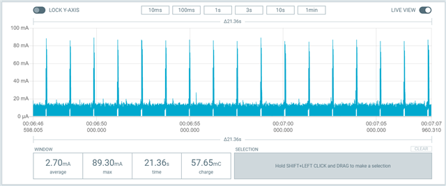

  • 2. After transmission, there are 24 peaks about 86.3mA each spaced 1.3s apart from each other and finally an 18s drop down to 20mA which I assume is idle state, why the 24 peaks? why i the idle current so high?

  • Hi, Styve!
    Thanks for reaching out.
    1. The peaks you are seeing after transmission are expected. This is a duration of time, given by the RRC Inactive Timer, where the device stays connected to and reachable by the network. Unfortunately the timer is decided by the network provider, so it's not much we can do about it. You could look into using Release Assist Indication (RAI), though that is not recommended when using TCP based protocols.

    Thanks for you quick reply, it has been greatly helpful. We do use PSM with TAU=10min and 1 min active time, so the device barely has time to go into PSM that we already TX the next packet. This is ok though, I just tested with longer transmission intervals and saw about 580uA in PSM (maybe idle mode?) with periodic peaks of about 21mA spaced 1.3s apart. This is still too high for PSM but would not matter in our use case.

    Good to hear, Styve! Then the behavior of your device makes sense. The spikes in (2) is the device checking the network during "active time". If the serial interface is active about 600µA is expected during PSM, but I'm not sure where the 21mA spikes originate from. However, there is no need to delve into that if it isn't of concern.
