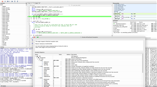

BusFault exception when debugging nrf9160 with segger ozone
I have written one application with logging disabled to save power.
However, when I tried to debug the code with Ozone, during startup, it raises BusFault exception.
According to call stack, it happened after calling nordisemi_nrf91_init in nrf91 soc.c file.
I loaded with the zephyr.elf file and chosen M33 as the target, with SWD 4MHz.
NCS 1.2.0 is used and I want to avoid any upgrade if it is possible.
Do you have any idea what leads to this weird behavior? And do you have the same issue on your side?
Thanks!

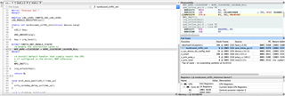

    Thanks for the response, but seems that does not fix the issue. Still get the same error.
    What does the "console" show now?
    In your original image, you can clearly see that it does not load from address 0:
    Here it uses 0x18200 as the base address, even when you do a reset from ozone. This will cause faults.
    Håkon
