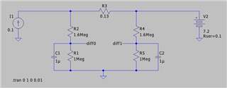

I'm working on using the SAADC in 14-bit sampling mode (oversampling set to x2) using nRF SDK 17. The supply voltage for my chip is 3.3V, and I have the reference set to VDD4 with a gain of 4. My understanding is that I should be able to get a resolution of roughly 0.2mV per bit with some fudge factor of noise.My sampling rate is roughly once per second with an acquisition time of 3us.
Please reference the rough schematic below for details. I'm experimenting with using the SAADC to measure the shunt voltage from a battery management system to a given attached battery. In the example I chose a current of 100mA, which should result in a shunt voltage of 13mV and a measured differential (between diff0 and diff1) of 5mV. Unfortunately this example, and even the case where I'm pumping 1A through the circuit do not give me the values I expect when compared to a DMM. Is there something weird going on with the extra apparent resistance due to the voltage divider? Maybe the SAADC isn't as accurate as I thought? I'm at a bit of a loss at the moment. Below is also some of the configuration code:
    Thank you for including a rough schematic - this is very helpful in order to quickly familiarize with the issue.
    My immediate thought when seeing this schematic is that your capacitors C1 and C2 are enormous for the task.
    I have not done any calculations on this yet, but I suspect that it takes a very long time to get the correct voltage levels here with such big capacitors.
    If you have not seen it already, I highly recommend reading through this blog post detailing how to measure the voltage of a lithium ion battery. In the blogpost, the circuit design and calculations are demonstrated.
    Could you go through the blogpost I referenced above, and recheck your capacitor value-calculations, and then try again with the new capacitor values if the results diverge from your previous calculations?
    You could also share your previous capacitor value calculation, and I'll take a look.
    For future debugging it would also be helpful if you could include some of the SAADC outputs you are seeing, compared to the value you are measuring with your DMM.
    On a general note I would also recommend using the internal 600 mV reference when measuring VDD voltage, since the results using VDD4 when measuring VDD will skew over time(as the battery discharges).

    I did see that tutorial, it was very helpful in understanding the SAADC a little better and was actually the reason I added capacitors in the first place. I oversized the caps in an attempt to make the final BOM a touch cheaper, and figured the increase in size wouldn't hurt. I didn't really do any calculations beyond the tutorial you referenced figuring that was a lower bound on what was required.
    I just wen't through some probably over-simplified math, my understanding is that the Thevinin resistance would be 620k, and approximating a fully charged capacitor to be at 5 time constants would give me 5*R*C=3.1 seconds. I'll go through the calculations you pointed out again and see what I get, do you think having a smaller capacitor would help? The battery is always plugged in, so I shouldn't have to worry about the charge up time in theory.
    Ah, I see. I must recommend that you always do these calculations prior to building a circuit, so that you have full control over what to expect when the circuit is live.
    As you can see from the tutorial, the calculated capacitor value they arrive at is 10 nF - which is 100 times smaller than the 1 µF you currently are using.
    How often do you intend to sample - are you not sampling every second?
    Yes, a smaller capacitor will charge faster - it needs to be small enough to have reached the steady-state voltage level in time for your sampling, for your measurements to be accurate.

    I am sampling about once a second, but the nRF shouldn't be able to drain an entire 1uF after it's charged, right?
    This is correct - the capacitor will not be completely drained by the sampling - so as long as the capacitor has enough time in between samples to always reach its steady state charge, then it would be fine.
    However, the capacitor does not need to be drained entirely for the samplings to be off - in your case, the capacitor takes much longer than the sampling interval to fill completely, and because of the unlinearity of capacitor charging curves, it will never make it to the steady state once sampling starts, and thus your samples will always be fluctuating because of it.
    So, by oversizing the capacitor you are also increasing the time required in between samples to ensure correct readings.
