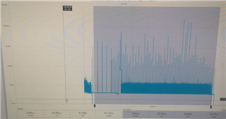

We are trying to maximize the battery life of our product and have come across this white paper: High pulse drain impact on CR2032 coin cell battery capacity which suggest flattening the peak current draws should help.
To that end, we measured an nRF52833 current draw in 3 use cases:
1. No capacitors added to board.
2. a 47uF capacitor added in parallel to the battery.
3. 2x 47uF capacitors added in parallel to the battery.
here are the results, in graphs obtained from the PPK:
No capacitors added:
In system off- ~1uA average with ~12uA peaks.
While transmitting (There is some overhead of current because of a peripheral but its current draw is more or less constant, so it can be ignored):

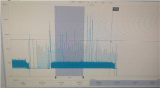

47uF capacitor added:
In system off- ~1uA average with ~4uA peaks.

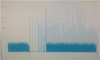

2x47uF capacitor added:
In system off- ~1uA average with ~3.1uA peaks.
Conclusion:
Adding capacitors in parallel definitely reduces the current peaks in system off mode, and it looks like it also helps reduce the current peaks while transmitting.

  • Item 1: I use 3x47uF on CR2032, not less than 6.3 volt but preferably 10 volt
    Item 2: PPK2 is better than PPK; not sure which you are using
    Item 3: The DC voltage applied to a ceramic capacitor causing a reduction in capacitance is well known, maybe see this FAQ link which shows a typical 50% reduction in capacitance using a 6.3volt rated capacitor at 6.3 volts; that requires a 2x increase in rated voltage for a given capacitance value or double the number of expected components fitted. My rule-of-thumb is 3x. See for example murata faqs
    TI also have a good white paper, though older: swra349.pdf (also swra347a.pdf and spreadsheet, not sure if any use swra347)
    we are currently using a 220 µF MLCC in parallel, which is rated for 6.3 V. It looks like that there is no buffering effect.
    Do you really recommend only an 47 µF capacitor?

  • Hi!
    We didn't apply any other filtering to the device.
    The peaks are not entirely gone, but they have been 'flattened down', which is the improvement we were looking for. These peaks are caused by the RTC and so are acceptable current draws. This power mode allows our units to 'wake up' from an external interrupt, which is what we'd like them to do.
    Asaf
  • No, the 47uF was just the example; minimum in our experience is 3 x 47uF so 220uF is a good choice. Note good practice is to isolate the drain from the battery by the nRF52 from other significant current drains where possible. A schottky diode works but wastes power; a better choice is an ideal diode such as the max40203
    The nRF52 has a 150uF separated from the battery by an always-enabled ideal diode; other loads connect to the battery with further capacitance and periodically pulse the battery voltage low for brief periods but the nRF52 is isolated from this drop in voltage and thus avoids brownouts or resets. Analogue circuits such as an AFE may be isolated from voltage pulses on their supply in a similar manner.
