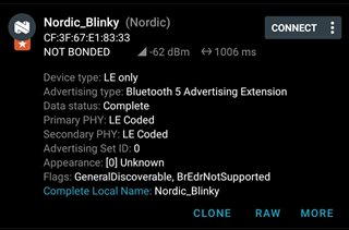

  • I have uploaded this code, device sometimes shows on my mobile (Oneplus 6T) but not showing in iPhone X and also other mobiles.

        ble_gap_adv_params_t adv_params;
        // Set advertising parameters.
        memset(&adv_params, 0, sizeof(adv_params));
        adv_params.primary_phy     = BLE_GAP_PHY_CODED;
        adv_params.secondary_phy   = BLE_GAP_PHY_CODED;
        adv_params.duration        = APP_ADV_DURATION;
        adv_params.properties.type = BLE_GAP_ADV_TYPE_EXTENDED_CONNECTABLE_NONSCANNABLE_UNDIRECTED;
        adv_params.p_peer_addr     = NULL;
        adv_params.scan_req_notification = 1;
        adv_params.filter_policy   = BLE_GAP_ADV_FP_ANY;
        adv_params.interval        = APP_ADV_INTERVAL;
        err_code = sd_ble_gap_adv_set_configure(&m_adv_handle, &m_adv_data, &adv_params);
        APP_ERROR_HANDLER(nrf_error);
