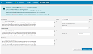

  • Hi again,
    I checked "you can look at this." I'm not 100 percent sure what I have to do but I understood that at the first I have to register this device to nrf-cloud.
    So here's what I have done:
    - I made exact changes in the file CONFIG_NRF_CLOUD_CLIENT_ID_PREFIX="own".
    - I created a json file which includes these informations;
    - After that opened LTE-Monitor and load from Json file and update the certificates.
    - I reset the board. But still, I get the same error when adding the device on the cloud side.
    I don't know I'm not sure if I know how to register this device.
    I didn't see or maybe I didn't understand how to register this device to the cloud.
    I really need a basic solution that goes step by step for that registery.
    Any help?
