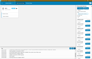

    I see advertisements from our legacy BLE 4.2 devices.
    Advertisements from other devices

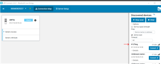

    My peripheral is advertising according to my BLE 5.0 enabled smartphone, my client's phone can't see it:
    From nRFConnect on Android
    And on nRFConnect for Desktop:
    I let the scan complete of course
