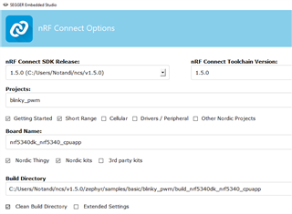

    I can build and run the blinky project, but if I try to build the biinky_pwm project
    I get the following error
    Looking at the readme.rst file for this project, 5340 is not mentioned.
    Are not all projects in the SDK meant for for 5340?
    Are there instructions for how to make it work?

    3. This is a issue in the board definition for the nRF5340DK in Zephyr. In short, the sample checks if the nRF5340 has a PWM led node in its devicetree (which is a data structure Zephyr uses for describing hardware) and it can't find any due to it not being listed. Thus, it fails.
    I'll see to it being fixed, but you can replace <ncs_root>\zephyr\boards\arm\nrf5340dk_nrf5340\nrf5340_cpuapp_common.dts with the attached file (which contains the rather simple fix).

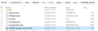

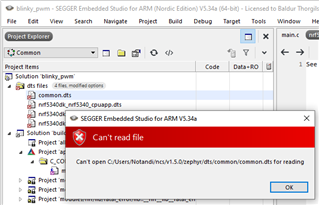

    I got curious about the file you mention (<ncs_root>\zephyr\boards\arm\nrf5340dk_nrf5340\nrf5340_cpuapp_common.dts). I could see it in my blinky_pwm project, but double-clicking on it tells me that I can not read it:
    I could find it in my installation path
    and looking at it in a text editor, it seems to define my nrf5340-DK on-board-resources  (pinout for leds, buttons,...).
    I guess that this file is common for all projects (and is thus not copied to each project) and as such the system makes it non-editable (since the board is fixed). Am I correct?
    If I was to make my own board, I guess I would make me a file like this that describes the on-board resources?
    Working with other ARM processors, the IDE typically has some kind of setup manager for the on-chip resources (setting clock frequency, enabling counters and so on - in general setting of all the processor registers). Is that what devicetree is about, or is there some tool that I am missing (similar to processor expert in NXP or STM32CubeMX)?
    If devicetreee.h describes the registers, I expect that it would be different for every project and thus under the project folder. I looked at my project folder and its subdirectories:
    C:\Users\Notandi\ncs\v1.5.0\zephyr\samples\basic\blinky_pwm
    but I could not find a devicetree.h for this  project.
