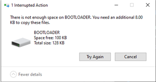

Hi, I used my NRF52840-DK for few times but suddenly the jlink connection was not detectable. Before the Jlink failed, the main controller on board did not bring up the board properly after switching on/off the power switch. USB connection was running after a reset on the main controller. I think the board needs reloading the firmware. Please provide me the procedures how to do it without a programmer. Thanks.
    To re-flash the onboard debugger push and hold the reset button while power cycling the board. Then you should se LED 5 start blinking slowly to indicate that the onboard debugger is in DFU mode, and you should see a removable mass storage device on your computer named "BOOTLOADER". Download the Interface MCU firmware from here and drag and drop it to the BOOTLOADER drive. After a while power cycle the board.

    I have the same problem, but my BOOTLOADER drive is too small for the J-LINK firmware. What could be the reason for that?
  • The board does not get recognized at all. When I open the J-Link Configurator it tell me there is no compatible board detected.
    And if it helps, this has happend to me with two boards. One was brand new and the other one was used for a while.
    Maybe some of the software that was on the board had an impact on the BOOTLOADER size? Is there a way to clear the board without using a programmer?

    That should not be the case. The firmware on the nRF IC does not affect this, as this should be isolated to the onboard debugger (the big IC with the white sticker).
    I do not have any particular reason for suggesting this, but as I am not able to explain what happened: Can you check with another computer to see if you experience the same on that (available size is 100 instead of 108)? Also, can you list all files you see on the BOOTLOADER drive, including hidden files and the size of all of them?

    So I have just been assigned to this project a few days ago. I was told that the board that was used already stopped working right and that I should try to reinstal the J-Link firmware. Before it was programmed using nrfConnect.
    The new Board was programmed using nrfConnect and for our application I needed to deactivate the massstorage device using the J-Link Commander, but that did not work because it was not detected. After that error I decided to also try and reinstal the J-Link firware using the BOOTLOADER but on both boards got the problem that we are talking about here.

  • Alright the problem is solved. I tried it last week on another PC that did not help but this week I tried another one and the size was 108kB so enough for the file.
    Thank you for your help!
  • This is a bit of a mystery to me, but good to here it was resolved. Thanks for letting us know!
