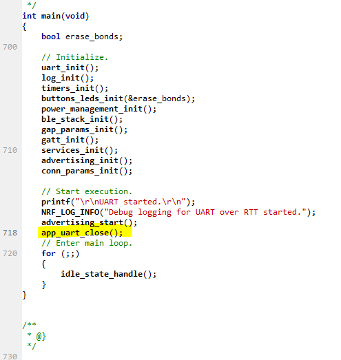

in the uart project I'm working on, when the programmed nrf52840 dongle connects to the other device over ble,
It is also programmed to send received data from arduino(UART data) to the other dongle which sends received data to usb so I can check the data in the PC
This also doesn't go to sleep in between sending uart signals.
So I would also imagine I'd have to go into uart data sending function like uart_event_handle() but there is no for,while loop in this or thread starter for that matter.
So how should I debug similar projects?
I'm guessing there must be some order that I can understand so I could pin-point which spot(code) is causing excessive power consumption
or what I have to do before putting it into sleep mode.

  • Maybe I should approach this in a different way. Instead of trying to cut consumption by disabling and enabling. I could just minimally enable functions.
    Because all I'm doing is getting 8bit data from rx pin periodically and sending it to another dongle through ble.
    There's a lot of functions and settings included in uart_init() especially APP_UART_FIFO_INIT() includes so many functions.
    I guess I could just pick what I just need and use only those for a new algorithm and hope it consumes minimally.
    Can I just enable rx pin only with 8bit buffer and make it listen while sleeping?

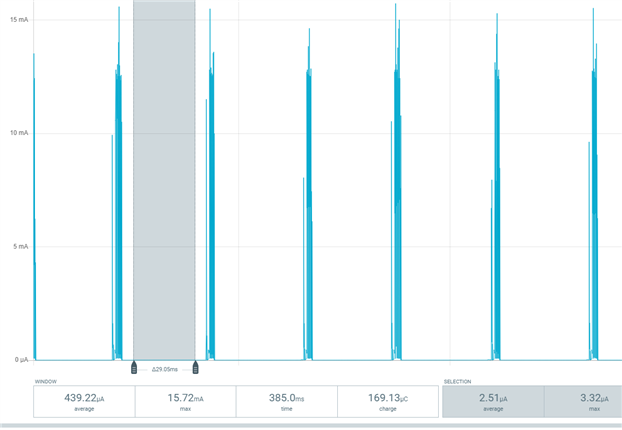

    I had a look at your code, seems that you still do BLE advertising. So the current consumption will include the BLE activity.
    I just did a test here with the ble_app_uart :
    And I got this:
    The current consumption when sleeping is only 2.51uA. I tested on a nRF52832 DK.
    I would suggest to test and measure the current consumption using a DK first. And then you can start testing on the dongle.

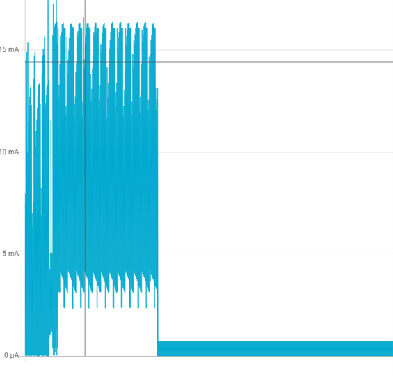

    Do you mean I have to explicitly disable advertising activity after connection? The current setup automatically connects to central dongle. It seems the current changes from advertising peaks to connected peaks every 30ms(one small peak and two high consecutive peaks after)
    I doubt this is needed because even when advertising, idle current is still pretty high. And only when uart_init() is commented out, it reaches the bottom both in ble connection, without ble connection.
