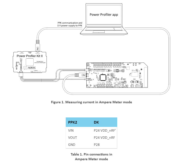

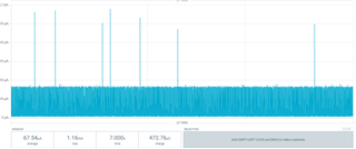

nRF 5340 DK High Idle Current
As the title states, my program (and a simple idle/hello world program for that matter) pull approximately 600-800 uA at idle. Same exact program, driver, and config on my nRF 52833 DK pulls about 8 uA at idle. I cannot figure out why this is. I suspect it has to do with the serial/UART interface and/or the network core? I noticed that even with "CONFIG_SERIAL=n" and "CONFIG_LOG=n" set in prj.conf I get output on UART/serial upon boot though it is from the bootloader. I did use the programmer tool to completely wipe the device (both network and app core) before I flashed it using West/Segger.
Output ("CONFIG_SERIAL=n" and "CONFIG_LOG=n")  :

Note I get about the same idle current draw whether SERIAL and LOG is set to yes or no.
Here is my project config and other relevant info:
I am building using nrf5340dk_nrf5340_cpuappns.

    I followed that solution and while it helped quite a bit it did not entirely fix the issue, see below:
    So to get this solution to work I had to enable the following the prj.conf:
    CONFIG_LOG=y

    After doing this I get an idle current of about 67 uA which is still a lot higher than the 8uA what I was seeing on the nRF52833 and expected on the nRF5340:
    Where else should I look to improve this? I have spent a ton of time digging through configs, documentation, etc. and am pretty stumped. Is there a good documentation pages I could dig into that maybe I missed?
    I also did some more testing with the simple hello world program and was able to get it down to 5uA idle current only IF I built the program using "nrf5340dk_nrf5340_cpuapp" instead of "nrf5340dk_nrf5340_cpuappns".

  • Got it, I understand how the 5340 is using multiple images now after your post and some more digging on my end. So yeah I went ahead and made those config changes and made sure it was booting using the samples/boilerplate you mentioned with the config changes you mentioned.
    Despite those changes I made to the config, I still have an idle current of ~70uA on the 5340 compared to ~7uA on my 52833
    I also added functionality to my application which causes it to enter deep sleep/system off with sense on a pin to wake/reset. In system off mode (pm_power_state_force(POWER_STATE_DEEP_SLEEP_1)) it draws about 14uA which is higher than I expected as well. I haven't tested this code on my 52833 yet but I feel like this is might be related to my high idle current as well.
    Where do I look next/how can I debug/what resources do I have at my disposal to figure out what is causing this?
    Is there anyway I can see what the PMU is doing via debugging?
    Edit:
    Also, I did try the hex for the blinky application you posted and I too get about ~5uA idle.
