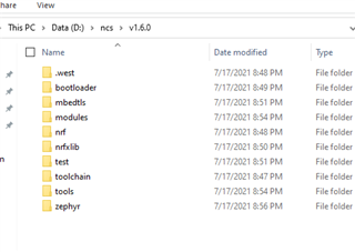

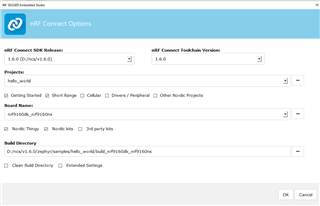

  • Hello, Danny!
    Thank you for reaching out. To make it easier for me to help you please provide the following
    - A screenshot of the how you setup the project when you select "Open nRF Connect SDK project"
    - A screenshot of the "Tools"->"Options"-"nRF Connect" options menu in SES.
    - Your OS.
    Please ensure that you did not install over VPN or similar. I also see that you installed NCS on the D: drive. Is it possible for you to try the C: drive?

  • Carl,
     Thanks for your support.
    Here is the info you asked for:
    - My OS is Windows 10 64bit
    - The screen shots are attached down
    - I have no VPN
    - First it was on drive C - Before I formatted the computer several times, because of that issue. Eventually, I moved it to Drive D. The drive does not have any impact.
  • I did. The location of the project did not change.
