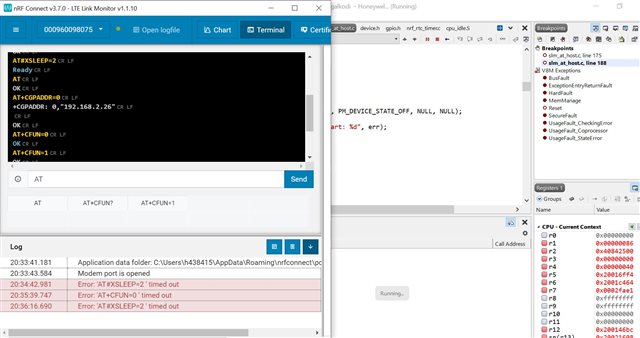

  • Hi Helsing, I am trying to put UART in sleep mode  using AT#XSLEEP=2.  I could see that If I put breakpoint  uart power on and uart powerOFF function  of SLM sample application this features works and if I remove the breakpoint is  not working.
    My Observation:
    UART 0 is enabled and UART2 is disabled
    Breakpoint is placed at uart power on() and uart power off() function
    provide the command AT#XSLEEP=2, break point hit in uart power off () function , run the progam
    Pressed Button 0 in the nrf9160 board , break point hit on the uart power on () function , run the program
    provide Any uart command it works
    BUT IF I REMOVE the breakpoints and do the same it is not working as expected , in fact nothing happens, what is that i am doing wrong.
    Please find the Link monitor terminal logs and screen shots attached for further investigation.  break points

  • Hi Ilan,
    Have you made any modifications to SLM? Have you enabled any configs or implemented the changes related to disabling flow control?

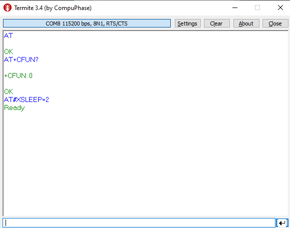

    I am not seeing this when I am testing SLM myself. I tested without any breakpoints, and when I press the button, I can see 'Ready' appear in LTE Link Monitor:
    Would you be able to share your project files?
    Håkon
  • Hi again,
    It looks like I have been able to reproduce this, and we might have a workaround.
    Exactly what is not working? Is the board not waking up? Are you able to send more AT commands? If you are not able to send anything it could be that LTE Link Monitor is failing.
    I have been able to reproduce similar behavior where LTE Link Monitor stops working after the breakpoints are removed.
    Could you please try debugging the board without LTE Link Monitor and switch to a dedicated serial output terminal? Here are the settings that worked on my side. Please note that you might need to select a different COM-port on your side. I have flow control enabled as I am using SLM out of the box.
    Below shows the use of AT#XSLEEP=2 and wake up by button.
    Please let me know if this works on your side. Is this a satisfying workaround at this stage? The issue you reported is is possibly a corner case related to LTE Link Monitory. Hopefully, you should be able to used LTE Link Monitor going forward with your project.
