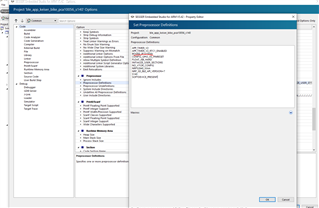

    The parameter that decides whether the DK is used is USE_DK == 1. It is now set to one and does not work because you need to press button 3 on the DK to start advertising. But no button press works. I have a default case where a message is printed should anything trigger the button event handler. Nothing does.

    It's because you're mixing the project settings for the DK with the dongle. Looking at the project settings, I can see that you are using the preprocessor definition BOARD_PCA10059 instead of BOARD_PCA10056. The former tells the compiler that it should use the board file for the dongle instead of the DK when it builds the project, which means that the buttons on the DK will not be mapped correctly.
    Fixing this, and replacing it with BOARD_PCA10056 fixes the issue:

  • OH! THat may answer why the Keil HEX file doesn't work when I install it on the dongle. So to build for the DK I use the 56 and for the dongle the 59.
    Gave it a try and it solved the issue! I would have never thought of that. Now all I need to do is to get the NVIC_SystemReset() to work on the dongle!
