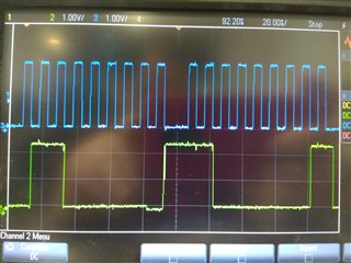

i am working with nrf52840, with zephyr (i am new to zephyr)
i am trying to connect to a low power magnetic sensor (si7210-00-iv)
my i2c sometimes works and sometimes fail (gets nack), not sure why .. maybe you have an idea ?
the i2c is configured to 100khz. and the init of the driver that uses the i2c is run before kernal and app,  i don't know if how or if i can configure stop bits or nacks or repeated start (if there is something like )

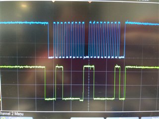

with oscilloscope looks like this (first photo is when it works, it can be seen that the 9'th bit is low on the second byte transferred):
the following photos are when i2c fail, on ack, and it can be seen that the 9'th bit is high in the second byte, which i guess signal the device something and it does not give a ack

    Could you show me your prj.conf file and the TWI initialization?

    The oscilloscope pictures looks alright to me, so I suspect that there here perhaps is a mismatch between what the sensor expects and what the nRF is sending. Does the Si7210-00-iv's datasheet mention any requirements for the TWI communication to be successful? I have no personal experience with this particular sensor, but I know that some sensors for example require a certain delay between commands to ensure that it has enough time to process them.
    Does the nack's happen after a particular command has been sent, or seemingly random / at any time?
    Karl
  • hi Karl
    the issue is actually related to the device in hand, which apparently requires an empty 'write' command which fail and it is normal for this device, so there where actually no problem with the i2c
