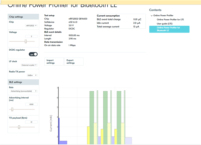

hi Karl,
i want to know is that what is the formula to calculate the ble advertising event length. I saw in online power profiler but didint get how this event duration is calculated
hi Karl,
Each of those three blocks represents the advertising on a single channel, so there are three in total. As you can see from the graph, it takes 573 µs to complete the advertising on each channel, for a total of 2379 µs to complete the full advertising event.
