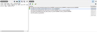

currently, I am working on my masterthesis. I have to develop an mobile application which comminicates with the nordic board via BLE. I know that there is an existing application from nordic but I had to implement some extra features. The example I use is the ble_peripheral_uart example. According to measure my traffic I am using Docklight.
My issue is that always when I try to send a notification with docklight to my application (Notification is enabled) my embedded studio crashes and I get a fatal error. Writing messages from the app to the board is possible. I can see this on docklight.
The confusing point is that when I started to write messages and send notifications it worked. But one day I tried it again and this error appeared, which is really annoying because I haven´t changed a single line of C-Code from the example. I tried to run a new version from the code, I tried to use different versions from my android studios code, I ran the code on several computers I changed the eval board, I changed the UART-Module I am using, I reinstalled the software - nothing worked.
I noticed that it is possible to send notification as long as I send only one letter or number. When I send more letters or numbers or add \n my code crashes. Obviously, it is a memory issue but I don´t understand why it worked at the beginning.
    Is this Segger Embedded Studio(?) that has a fatal error and crashes, or is it that you see a fatal error in the log from the nRF? If it is the latter, then this is likely from an APP_ERROR_CHECK. In that case, testing a debug build (select "Debug" from the build configuration dropdown menu) will give you more information. With this you should see file name, line number and error code, and that will give us much more to go on.
  • Yes, I am using Embedded Studio. These are the error codes I get when I try to send a notification. But I have to add, that I made a mistake in my explanation. I can send more than one sign as long as I don´t add "\n". The point is that I need \n because without it, I have to send several packages until my app gets the packages.
    Is it possible that it is something like a cache problem? Because no matter on which device I ran my C-Code, first it worked and after a few trys I got this error.
  • I see. The APP_UART_COMMUNICATION_ERROR means that there was an error in the UART communication. The API doc indicates how you can know more about this error:
        APP_UART_COMMUNICATION_ERROR, /**< An communication error has occured during reception. The error is stored in app_uart_evt_t.data.error_communication field. */
    This is the number you provide to APP_ERROR_HANDLER, and from the printout we see it is 4. In this case, this does not mean NRF_ERROR_NO_MEM but that is printed as that is the standard meaning of error codes in the nRF5 SDK. In this case, the number is from the ERRORSRC register in the UART peripheral, as we see form the API documentation for error_communication you found:
            uint32_t error_communication; /**< Field used if evt_type is: APP_UART_COMMUNICATION_ERROR. This field contains the value in the ERRORSRC register for the UART peripheral. The UART_ERRORSRC_x defines from nrf5x_bitfields.h can be used to parse the error code. See also the \nRFXX Series Reference Manual for specification. */
    Looking at the UARTE chapter in the product specification you can see that 4 in ERRORSRC is FRAMING:
    Framing error occurred. A valid stop bit is not detected on the serial data input after all bits in a character have been received.
    There are several reasons you could get framing errors. Assuming everything is OK with the other UART device and there is no logical error, it could for instance be simply that you are using HFINT instead of HFXO, and that will not be accurate enough. If that is the case you would typically see the issue more with longer packets or higher baud rates. And the fix is to request the HFXO before doing UART communication.
