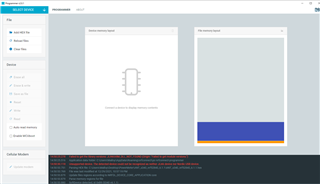

  • Thanks. I'm not even sure where to be looking for where the device would be advertising? It's not registering as a USB device in Windows Explorer any more. Double tapping the reset button the board does not put it in DFU mode any longer either, as it did with the Adafruit bootloader.
    I tried to run the following with nrfutil... Not sure if this is the correct procedure to "generate the updated package".

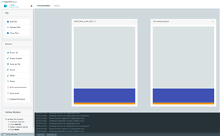

    Here is what nRF Connect-Programmer looks like after putting the ANT_s340_nrf52_7.0.1.hex on the board.
    That's where I am at currently.
  • Enjoy your time out of the office. Thanks for continuing to help me through this challenge of getting started.

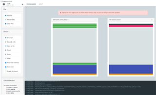

    From the last figure, it seems there is only the ANT_s340_nrf52_7.0.1.hex on the device. It would need to program the Adafruit bootloader.
    -Amanda

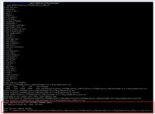

  • I think we are getting closer... Thanks for all of this.
    I am encountering the following when doing $ Make BOARD=... There seems to be an issue with nrfutil and 'genpkg' for the .zip file. Are there any suggestions regarding the error in the image below?
    Please correct me if I'm wrong... I'm not so sure the .zip file even matters since the UF2 and Hex files were made and UF2 file and largest .hex file (itsybitsy_nrf52840_express_s340_bootloader-0.6.3-48-gcc8ea2b-dirty_s340_6.1.1.hex) are able to be flashed to the board (either by drag/drop of UF2 onto the board when in DFU mode, or by nRF Connect-Programmer and JLink with the .hex file). From there the board is accepted (in Arduino IDE) now and operates as it normally did. I've been able to run simple test sketches of blinking the on board LEDs and sending printed text to the serial monitor, so I seem to be back to baseline with the board operation in this regard.
    ^-- Does this image/figure look correct regarding the bootloader program aspect? Since yesterday, I have been able to run test LED blinking/print line sketches, I wouldn't be able to do that if the bootloader was not available, right?
