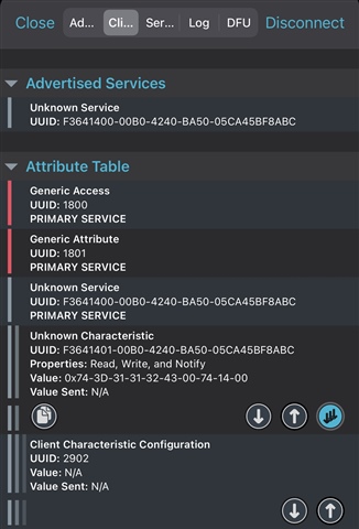

Changing the representation of the BLE characteristic data
Is there a way to convert the data representation of the BLE characteristic into, say, strings?
Secondly, any way to debug as to why am I seeing more bytes than what i'm sending from my application? I am sending 6 bytes so 0x74-3D-31-31-32-43 and the rest isn't meaningful.
Lastly, any way to set the service name? currently it says Unknown. Perhaps it would remain Unknown until the UUID is recognized by the central?

    How though? I'm sending char bytes and it's showing as hexa as you can see in the screenshot above
    The screenshot is from nRF Connect, which is a mobile app made by us. It only includes names for services and characteristics that we included. You can use others based on UUID for testing though, but in order to see names etc. you will need your own iOS/Android app that you must develop yourself.

    Yes, I created my own service but that alone isn't enough for the client app to recognize the UUID as you mentioned. And there's no way to customize the nRF Connect app to do so?
    my main point of concern was the data representation for this question, and not the service name. So I guess that only needs to be modified in the implementation of the mobile app itself?
    No, that is not configurable in the nRF Connect for mobile app. You will need to make your own app if you need it to recognize your custom service. Note that it is not needed for testing though, as you can read and write any characteristic of any service (known or unknown) in nRF Connect for mobile, so that should work as a development tool.
    Yes, the data representation also needs to be modified in the mobile app (when you send data in nRF Connect for mobile you can select data type, but currently not for receiving data. That is always displayed as a hex).
