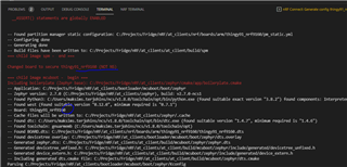

During building the project, the output terminal showed some suspicious lines. Despite I choose the non-secure board version 9160ns when creating project configuration, it has flipped back to secure board version during building time without asking me. I don't know what this actually means. See below:
Also, there are some warnings here, which also seem not understandable for me. Not sure if they mean anything for this issue.

    Probably the problem is somewhere in switching board to non-secure mode. Screenshot from the first post below.
    But I just don't know why does it change the board and how to prevent it from that. May be this could be the solution?
