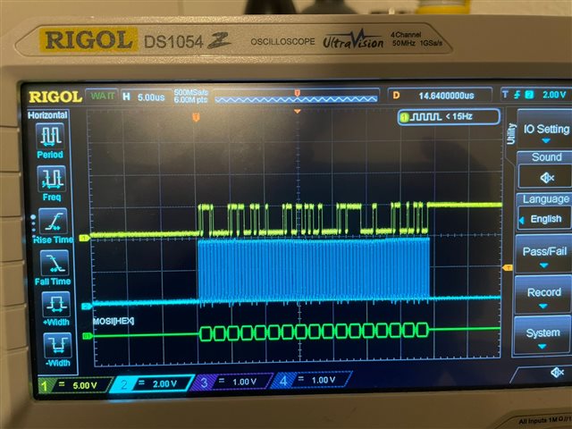

I am trying to use the NRF52832 to connect to the BMA456 Accelerometer from Bosch using SPI and am running into the following issue:
- All read/write commands work fine except for the burst write of the configuration file.
- I decoded every single SPI transfer to the sensor while the configuration file was being written (in chunks of 16 Bytes) and have only noticed the following behavior (which I honestly don't know if it is normal or not): after some packets the MOSI line remains HIGH, and some others it goes LOW, without a noticeable pattern.
From a first glance, the entire config file seems to be written, but clearly, something is going wrong during the process and I haven't been able to debug it on my own so far.
Other hypotheses I eliminated:
- faulty sensor hardware: the sensor works fine with an Arduino so that's not it
- an error in the board design/wiring of the NRF52 on my board: the SPI bus works well with other sensors on the board
I've been tracking the issue and apparently, others have had the same problem with I2C and other Bosch sensors (like the BMI270), but I still don't know how to fix it.
