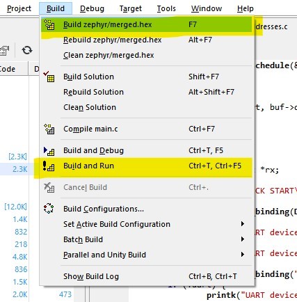

    It seems to me that the changes to the overlay file make no difference, how can I check?
    These are the files that I'm changing.
  • You can't use those tx and rx pins without changing a few things in the board files, which will impact the network core.
    That's why I recommended using pin 34 and 35 instead.
    You can check whether the overlay is being applied in build/zephyr/zephyr.dts
  • As i suspected the .dts file is not changing, do you perhaps know what the reason would be?
    I change the overlay file and then in Segger IDE run these 2 commands.
    Is that enough?
  • Oh, no that is not enough. When using SES, you need to run "Project->Run CMake" after changes to overlay files, prj.conf etc.
  • Now when I use run "Project-> Run CMake" .dts file is changed and looks fine.
