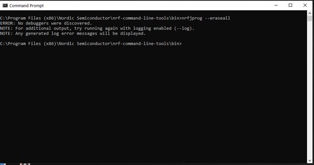

  • Hi Simon
    I have used the command line tool please see attached.
    We really need to get to the bottom of this as we have brought a few to test, with the view of changing existing BLE suppliers to Nordic.
    Kind Regards
    David
  • Sorry, the Dongle will need to be connected via a debugger (the one on the DK for example in order to communicate with the command line since it doesn't have a debugger onboard.
    Either way since it's a problem with multiple Dongles I would think this is on the computer/nRFConnect app side rather than with the Dongles. Are you using a USB hub or do you connect the Dongles directly to the computer? We've also had some reports with issues when connecting to USB hubs.
    Do you by chance have another computer available that you could use with nRFConnect and try to connect to?
    Simon
