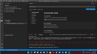

Screenshot of error message
Hello, I've followed the steps required on YouTube for setting up VS code with nrf Connect for desktop and the toolchain manager. It didn't work for me on Windows 10 and I've just updated to a clean install of Windows 11 and it doesn't seem to be working for me here either. I'm getting the following error message as you can see in the screenshot:
Building blinky
west build --build-dir c:\Users\saulm\ncs\apps\blinky\build c:\Users\saulm\ncs\apps\blinky --pristine --board nrf52840dongle_nrf52840 -- -DCMAKE_EXPORT_COMPILE_COMMANDS:BOOL=On -DNCS_TOOLCHAIN_VERSION:STRING="NONE"
usage: west [-h] [-z ZEPHYR_BASE] [-v] [-V] <command> ...
west: error: argument <command>: invalid choice: 'build' (choose from 'init', 'update', 'list', 'manifest', 'diff', 'status', 'forall', 'help', 'config', 'topdir', 'selfupdate')
The terminal process failed to launch (exit code: 2).
Terminal will be reused by tasks, press any key to close it.
Additionally there are some errors VS code has in reading the program as shown here:
#include errors detected. Please update your includePath. Squiggles are disabled for this translation unit (C:\Users\saulm\ncs\v1.8.0\apps-saul\blinky\src\main.c).
cannot open source file "zephyr.h"
cannot open source file "device.h"
cannot open source file "devicetree.h"
cannot open source file "drivers/gpio.h"
The SDK and toolchain are up to date as of 2022-02-07. And I"m using the Nrf52840 dongle which is recognized by VS code. My install  and application directory are visible in the first terminal output message. I would appreciate your help trouble shooting. Perhaps you'd know what commands I could type in the terminal (and which terminal to use) to see if west can be located. Any assistance would be appreciated.

    I have done so, and I did just try again with another install of everything, this time following the order of installation as shown in the video. Again I get the same error as above when I try to add a build configuration to my application. Your advice on the steps I could take to troubleshoot the problem would be appreciated.
    From the west error you get, west is not initialized, which is why build is not a valid choice. If you were to open a terminal and build on command line with "west build ..." in your application folder, c:\Users\saulm\ncs\apps\blinky, then it would make sense that you are getting this error, since ncs\apps\blinky is not a west folder. However, when building in VS Code, either when when adding the build configuration or by selecting 'Build' under 'Actions', this should not be an issue, as the nRF Connect extension should fix this.

  • Thanks Marte, for your assistance. I have a few things to report. You are indeed right that it seems West was not initialized. When I opened a terminal from the toolchain manager and navigated to my application file and ran "west init" and then "west update" I was then able to build the application, but it then ran into errors of a different type. So it seems you're on the right track.

  • Ok. I deleted the 1.8.0 folder and re-installed everything and now 1.8.0 is now working. I believe my problem was that I did not have Python3 installed at the time I installed 1.8.0 and so west didn`t initiate properly.
