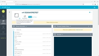

However, after adding the prj.conf file, now it does not send emvironmental pressure and button press values. How can still receilve those values into NrfCloud, along with temperature and moisture that I already receive?

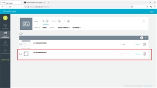

  • Then it seams that it sends data again, but as it appears ad "Disconnected" in NRFCLOUD, I can see nothing there.

  • Looks like the connection indicator on nRF Cloud UI is not working properly.
    It looks like your device is able to send data to the cloud, while at the same time nRF Cloud UI reports the device as disconnected.
    Could you verify that the message your device is sending arrives on the cloud side? You will find all messages received by nRF Cloud using the ListMessages REST endpoint. If the endpoint returns your messages, and you can verify that your device keeps sending in more messages, then you (and your device) are fine, and it's a bug with the connection indicator.
