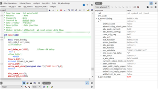

 kindly suggest what to do for switching into config mode.... I haven't added any services yet but in future will be added.
Thank You

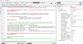

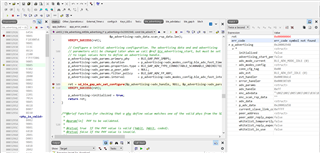

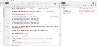

    Are you sure error 4 occurs in advertising_init(), and not in some of the other calls in change_to_app_ble_advertising_init()? If you use Segger embedded studio and  select the "Debug" build configuration you will get a more detailed crash log, which in addition to the error code, will include the file name and line number of where the error occurred.
    The commented function calls below can be moved to main()
    void change_to_app_ble_advertising_init(void)
    	bool erase_bonds;
        //gap_params_init();
       // gatt_init();
        advertising_init();
        //services_init();
        //conn_params_init();
        advertising_start(erase_bonds);
    Vidar
  • Hello Vidar,

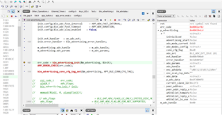

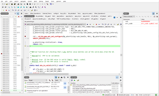

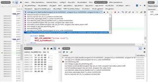

                      If I start debugging in debug configuration, the project does not get started... It gives errors but the code is working in release configuration. I don't know-how.
    Please post a screenshot of the errors you get.

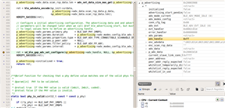

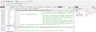

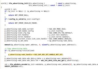

  • The screenshot is for your release build, so I can't tell why the debug configuration is not working for you.
    Anyway, the NRF_ERROR_NO_MEM is clearly from advertising_init().  My guess is that the error is returned from the sd_ble_gap_adv_set_configure() in ble_advertising_init() because you are using a different advertising handle. You should reuse the same adv. handle when you do connectable and non-connectable advertising:
