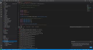

I installed the tools via nRF Connect Desktop / Toolchain Manager in a project directory, but it looked like the paths got too long. Then I uninstalled the stuff via nRF Connect Desktop / Toolchain Manager, uninstalled the nRF Connect Desktop, removed the stuff from the project directory and rebooted. Then I re-installed everything at C:/ncs, but when I try to do something, it still defaults to the deleted project directory.
Also, when I tried (after re-install) to create the shell_bt_nus from an example and into another folder, I got the ELF-files (ARM code), but the Visual Studio Code shows errors:

The first two seems to happen, because __GNUC__ seems to not been defined.
And in the target folder it generated .vscode-file with this content:
    "configurations": [
            "name": "Win32",
            "includePath": [
                "${workspaceFolder}/**"
            "defines": [
                "_DEBUG",
                "UNICODE",
                "_UNICODE"
            "windowsSdkVersion": "10.0.19041.0",
            "compilerPath": "C:/Program Files (x86)/Microsoft Visual Studio/2019/BuildTools/VC/Tools/MSVC/14.29.30037/bin/Hostx64/x64/cl.exe",
            "cStandard": "c17",
            "cppStandard": "c++17",
            "intelliSenseMode": "windows-msvc-x64",
            "compileCommands": "${workspaceFolder}/build/compile_commands.json",
            "configurationProvider": "nrf-connect"
    "version": 4
I don't think it should use that compiler for anything.
It also found some errors from code for other HW!
Is there a way to "make clean"? I didn't find any.

  • It works (compiles and generates the elf and hex files), but not properly.
    The main issues:
    - wrong C code parser the VS Code (Intellisense?) uses (being studied, I understood - the problems tab)
    - configuration defaults from previous installs (wrong SDK version, etc.)
    - changes watcher crashing (if I restart it, it checks the changes OK, and crashes after that)
    - the Intellisense configuration (c_cpp_properties.json) seldom gets generated.
    The changes watcher wakes up all kinds of configurations. If you add a file, the IDE won't notice, and doesn't run cmake, unless you restart the changes watcher (which crashes after that).
    I don't have a board yet, so that's how far I have been able to try.

  • Hi
    One of our developers of the VS code extension has looked into these issues and have come with the following comments.
    We have merged a PR into the latest main branch that addresses these multiple errors/warnings in the problems tab to only show them for the open file(s). We might add more filtering later as that likely will be useful.
    Fhe Z_FOR_LOOP_1 issue you've seen is fixed in the NCS master, and is not actually a VS code issue. It was due to an abuse of the preprocessor in the logging macros.
    Simon
  • The notification in the lower right corner. If I click "reload", it does something (probably checks for changed files) and right after that, the notification emerges again. Also after some configuration changes, nothing happens until I click that "reload".
