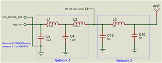

For 52820-QDAA, what load impedance is preferred seen into the matching network?   I mean the total load impedance of C3, L1, C4, L2, RF trace and antenna.

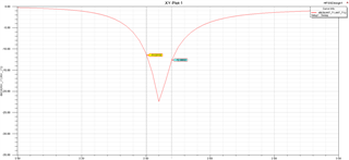

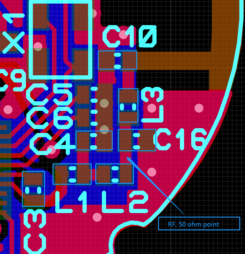

Since our product is small and layout can not be exactly same as recommended, we have to change C1, L1, C4, L2 values if needed, then measure impedance at ANT PIN to make sure to be preferred by 52820-QDAA. So we need to know the load impedance seen into the matching network

  • The matching networks for the nRF52833 QIAA and nRF52830 QDAA are identical so the same applies for the nRF52820 as well. You should see 35 -j46 ohm into the matching network from the ANT pin.
    But this will only tell you how to match it for the best output power and sensitivity. It doesn't say anything about attenuation of the harmonics. So pay attention to that as well. This is especially important when you transmit with 8 dBm.
  • Hi ketiljo, when I am trying to get 35 -j46 ohm seen into the matching network from the ANT pin, I got a good point, but what is the frequency when we say 35 -j46 ohm?  Is it 2400 Mhz, or 2440 Mhz? If we are talking about different frequencies, then there must be a deviation.
  • Middle of the band, 2440 MHz.
