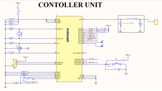

I'm using app_ble_uart example using nrf52810 for nrf52810 UART RX & TX pins are (P0.15 - P0.14) while configuring using i got a problem with RX transmission ,when i changed to Rx pin as p0.15 the nrf52810 module is not working.

I do not see anything obviously problematic in the schematic.

i have a question is it required to pullup the RX pin in Custom board to work on that
You need to ensure that the inputs are not floating. If the UART lines are always connected to another device on the board, and this always drives the input lines to the nRF ( Rx and optionally CTS), then there is no need for pullup(s). If not, you can enable the internal pullup. See this post.
Hear my UART lines TX and RX are connected to "QUECTEL" module when the Quectel module is on nRF device working fine, when i turned of the Quectel module which is connected to UART then nRF is also going to turn off automatically.
