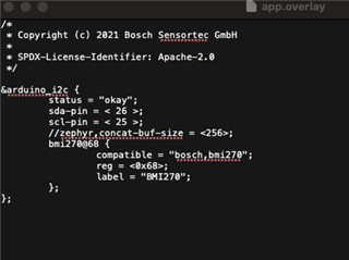

  • Hello. I used the bmi 270 example provided by zephyr https://github.com/zephyrproject-rtos/zephyr/tree/main/samples/sensor/bmi270
    With overlay file modified as such to use pins 25 and 26 for scl/sda:

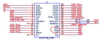

    I attached them to these pins on the breakout board:
    Zephyr.dts looks like the following:

    The overlay looks ok. Have you scoped SCL and SDA pins to see if there's any activity?
    Both pins shall be active low, ie. idling at VDD.
    Håkon
