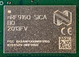

    This current batch of custom boards had nRF9160 revision 1 Build code B0.
    For the next batch, we have used nRF9160 revision 2 Build code B1. Modem firmware will be 1.3.1. Do I need to update ncs version v1.9.1?
    Do you think the certificates are deleted because of the older versions of modem firmware and ncs?
  • Can you please provide an image of the device markings? Also, can you please run at client and issue the command AT+CFUN?.

    One of the nRF9160 chip's image (I guess this what you meant for device's markings)
