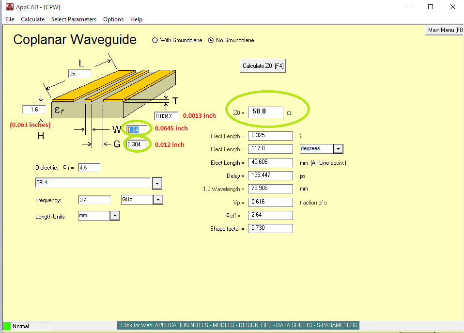

The first thing i start by calculating the Line width to match the 50Ω characteristic impedance. its mandatory to know the PCB material, for that i'm gonna use the 2 PCB layer from OSHPARK. their characteristic for PCB are :
  • All 2 boards are FR4 170Tg/290Td
  • They’re 1.6mm thick (0.063 inches) with 1 ounce copper on both sides.
using the AppCad software i tried to calculate the trace width , the result are bellow :
image description
the size are they correct ?

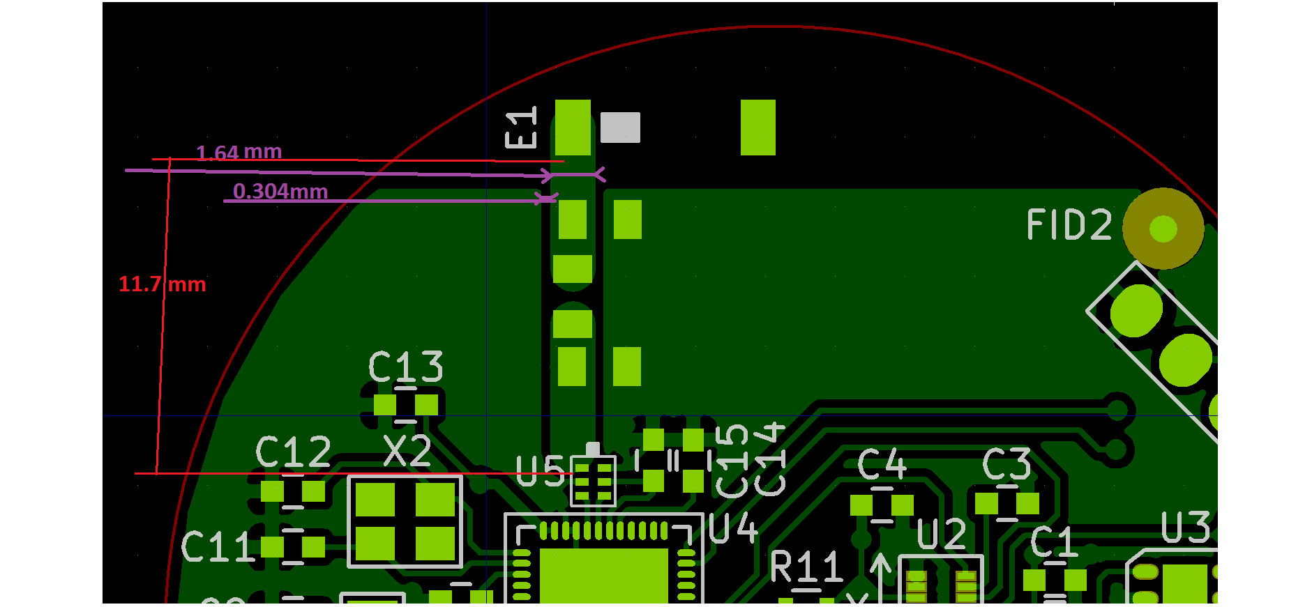

and this is how its looks like my PCB
image description
i put also a PI network and i didn't know how can i guess approximately the value of the PI netwrok ?? or should i put a shunt resistor with 0 Ohm then use the Spectrum analyzer ? is there other solution than using Spectrum analyzer to tune the antenna ??
What do you think about the PCB ? can i have a chance to get a good RF transmission ?
  • Hi Tizana,
    Why don't you have ground on the bottom layer ? Having proper ground improves RF performance.
    Other than that your schematic and layout look good.
    To be able to find the value for the PI network (to tune the antenna to meet 50 Ohm impedance because the environment, such as plastic case, housing will affect the antenna), you would need the network analyzer. The spectrum analyzer would not be sufficient.
    However, you can send your prototype to us. We will to the turning for you and send you the value of the tuning network (and the prototype )back.
    If you just want to have a prototype that works with OK range, your design should be fine. Just use 0Ohm resistor for the series component in the PI network and leave the other 2 open.
