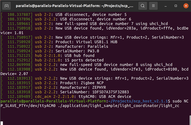

- I'm trying to run the light_zc example on Linux VM running on MAC.
- I've loaded the Zigbee NCP firmware on a dongle on MAC
- I'm running the light coordinator example on Linux
- When I run the application, it just sits there

When I say "it just sits there" is that after running the executable, I do not see any printout of any kind.
I tested this myself, and I believe there might be an issue with using the Dongle as NCP gateway on VM. I first got permission denied, and after fixing this I now get an error that serial read failed. Using a DK it worked as expected. I will look more into this and check with the developers. In the meantime, can you upload the log from the NCP Host? It should be located in the NCP_HOST_V2.1.1 folder and called simple_gw.log. Preferably delete the log that is already there, then run the command to start the gateway (NCP_SLAVE_PTY=/dev/ttyACM0 ./application/simple_gw/simple_gw), and upload the new log here.

As I mentioned earlier there is an issue with permissions, as the VM doesn't have dialout permission. I thought I fixed the issue by giving it permission, but the new problem arose because the NCP host resets the NCP SoC right at the beginning, causing the USB device to be temporarily removed from the system. Because of this I had to share the dongle with the vm again, but then it did not have permission anymore.
I solved this by running the NCP host with sudo:
sudo NCP_SLAVE_PTY=/dev/ttyACM0 ./application/simple_gw/simple_gw
I still had to share the dongle with the VM again after the removal, but after doing this the communication was reestablished and the host resumed the initialization process.

I've changed my user permissions and restarted
sudo usermod -a -G dialout $USER
Then I ran the light coordinator example (and the simple gw)
Then I started up the light bulb sample device

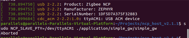

with simple gateway I get "aborted"
Same with the coordinator
In the case in your first reply was the light coordinator able to create a network so that the light bulb could join? It would also be useful if you could run a sniffer to look at traffic on the channel the coordinator is trying to create the network, because then you will see if the coordinator actually creates a network or not. You can use nRF Sniffer for 802.15.4 for this.
It is hard to say what the issue is without looking at the log, so please upload the log from the NCP host. You should find it in ncp_host_v2.1.1, and it should be called simple_gw.log and light_zc.log.
