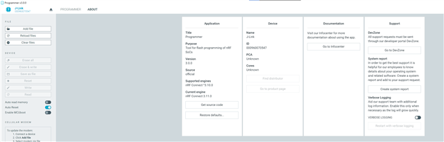

Hi there,
This morning I updated to the latest version of the nrf connect for desktop, along with all the extensions (LTE Link Monitor, Programmer, Toolchain Manager).
However I cannot seem to detect my nrf9160 DK anymore. It does not pop up in the "Select device" on any of the apps. This is extremely frustrating. When we toggle the switch to the nrf52 however, the dk gets detected, but when toggling the switch to the nrf9160 position, we can not detect the DK, and only the J-link pops up within Programmer app:
Unfortunately I do not remember the previous versions of any of the app I had. Please advise a workaround for this ASAP!
  • We can not program the nrf9160 at all, not even from Segger Embedded Studio as it fails to connect to Jlink:
  • The same issue is specified in this post.
    When running "nrfjprog -v":
    nrfjprog version: 10.14.0 external
    JLinkARM.dll version: 7.58b
    When running "nrfjprog --recover -f nRF91 --log", we get the following log.log file:

  • We have recently played around with the VDD_IO switch (SW9) on the DK. According to this post this can also cause issues? If this is the cause, how do we recover from it?
    We do need a response on this ASAP please.
    Frikkie
  • Hi Frikkie,
    Sorry for the late reply, just back from a national holiday vcation.
    I think you need to identify if this is an issue with nRF9160DK or something wrong on the computer side. This could be verified by either of the following solutions.
    1) Try your current DK with a new PC.
    2) Order a new DK test with your existing PC.
    If this is an issue on nRF9160DK, and its j-link has no issue to access. Could you reprogram the default nRF9160DK firmware(App+MFW) by following Getting started with nRF9160 DK — nRF Connect SDK 1.9.1 documentation (nordicsemi.com)?
    Charlie
  • Hi Charlie, thanks for the response and I hope you had a good holiday.
    I have connected a different devkit to my PC this morning and everything is working fine, hence the problem should be on the devkit of the original device.
    I will try to reprogram the device and keep you updated, but I suspect this is not going to be successful as we can not connect to the 9160 at all.
