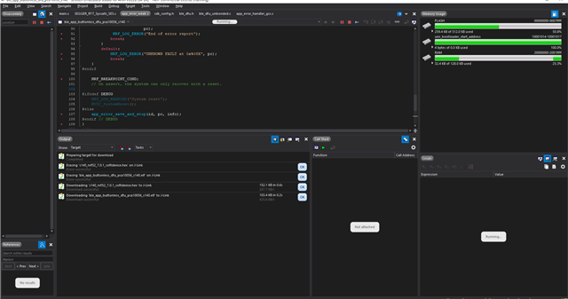

  • Thank Hung, now I can upload bootloader first and upload the ble_buttonless without "erase all" step when  i upload by JLink. (Please confirm for me this step to make sure that I didn't erase bootloader.)
    But I got this problem, my application seems stuck at somewhere my debug terminal doesn't show anything but running like image I attach.
    if I don't upload bootloader first I will get "no bootloader was found" error
    Here is step I implemented
    step1: build and upload secure_bootloader_ble with new public_key.c
    connect jlink -> erase all -> download
    step2: build and upload ble_buttonless_dfu
    connect jlink -> download
  • Hi Rocklee,
    Please, have you tried to follow my blog ?
    You would need to get familiar with the bootloader first before you move to the buttonless application. Please flash bootloader + softdevice first, then do DFU update with the heart rate example. After that you can test DFU the buttonless.
    Don't flash the application with Jlink. To flash the application with Jlink, you need to generate the bootloader setting.
