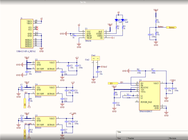

Current consumption on NRF52833 is too large
Hi, I now aply ble_app_uart example for my custom board

Some configurations in my code based on ble_app_uart
Advertising_interval : 64ms
Tx: 0
Some changes compared to original ble_app_uart example

I expected current consumption is about 0.5mA
But I got 20mA for this application on my board
I only changed some configurations I atttached above compared to originanal ble_app_uart example
Here is my schematic
Here is the link of datasheet of my nRF52833 module
http://en.abluetech.com/uploads/soft/201608/PTR9813_EngV1.11.pdf
I use ptr981x nRF52833 module
