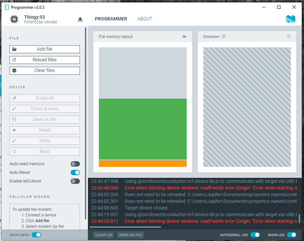

2. Updating through USB: This method fails for any firmware that I want to update, since it indicates the message "Error when fetching device versions...", so it does not activate the Write icon.

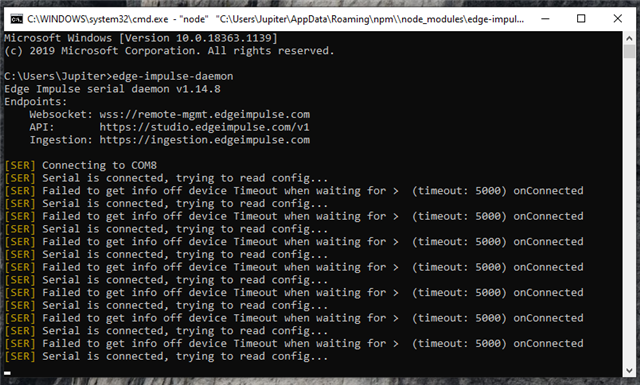

    Before upgrading any firmware, I tried to connect this thingy:53 to Edge Impulse via PC-serial port with command "edge-impulse-daemon" and it didn't connect.

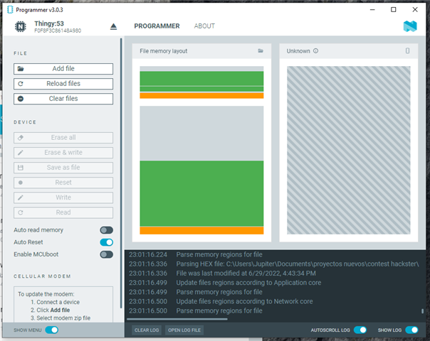

    3. I followed your instructions. When I tried to install Edge Impulse firmware using this compressed file "2022-08-03-precompiled-application-firmware.zip" provided on the Nordic website, I got the error below:
    And the "Write" icon was not activated.

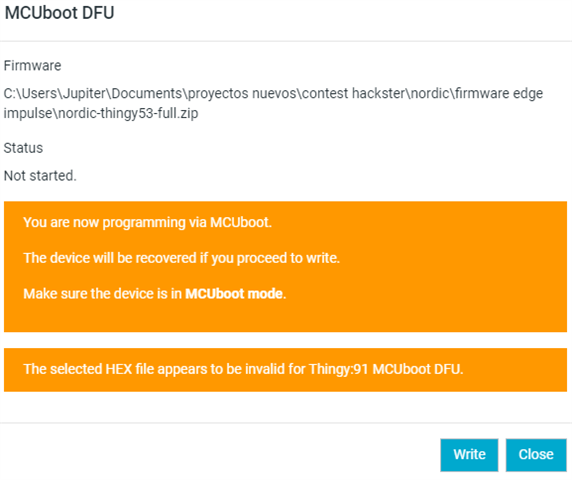

    But when I useed the firmware found on the Edge-Impulse website (nordic-thingy53-full.zip), I got this message:
    There is no error and the "write" icon is not active either.

  • Hi Guillermo,
    While updating through USB, it should choose the zip file as edge_impulse_1.0.0_thingy53_nrf5340.zip under 2022-08-03-precompiled-application-firmware\Edge_Impulse.
    .hex files are for the external debugger programming.
    We are fixing the bug as you see from that case. Sorry for the inconvenience.
