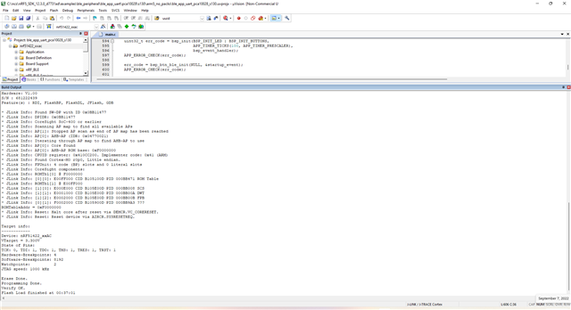

Hello, I am currently trying to program the uart example code from the nRF5_SDK_12.3.0_d7731ad zip file. After dealing with various reference address and device package issues, I am now able to flash the softdevice and progam sets to the chip. However, the chip is not advertising and it does work with the premade hex file. At this point I have no idea what could be wrong, the only noticible difference between the hex file layout in nRF Connect and the flashed softdevice and code from Kiel 5 is shown in the attached image, with hex file on the left covers the register address from 0 to 0x0001E3F7 while the flashed program from Keil goes from 0 to 0x0001E3FF. Other than that the recovery error is shown in the command window, but this occured even for the hex file which would advertise so I am unsure how to proceed.

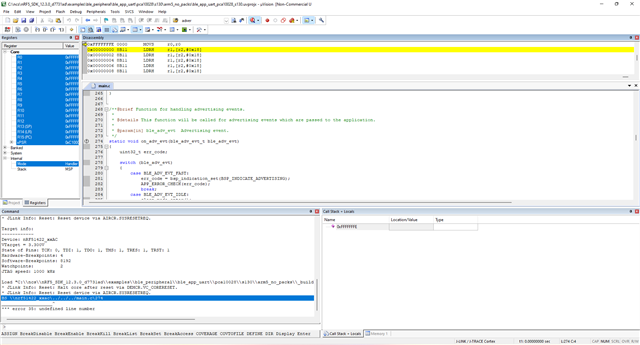

  • Can you show me the build and flash log of when you're flashing the application onto your device? And what device are you using for scanning for advertisements? If you have an nRF52 DK or other supported board, you can use the nRF Sniffer and Wireshark interface to sniff for BLE advertising data to make sure whether the device actually advertises or not.
    Have you tried debugging the application to see whether it runs as expected or if it stops or returns any error codes at some points?

  • Hello Simonr,
    Attache are the build and flash logs of the application.

    I am using an nRF51 DK, so I don't believe the Sniffer would work. As far as advertising the device itself does advertise just fine when using the premade hex files found when you download and unzip the example files. Its only when I'm trying to manually flash the softdevice and application Kiel 5 code also found in the examples folder, which I am using the one in the s130 folder based on nRF51422 parameters. From what I can tell with debugging it doesn't seem to throw any errors unless I place a breakpoint, such as at the labled initiation of the advertising, at least from my limited understanding of the debugger for Kiel, as shown below. The error however does not make much sense to me.
