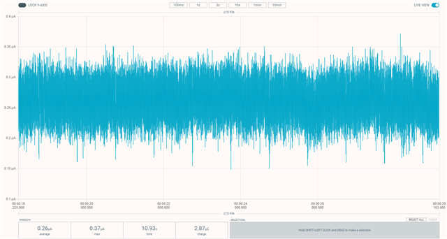

  • Hi
    Okay, this sounds like the PPK2 is not working properly then. I have tested the empty APP core sample that should provide very low power as it just keeps the system OFF. If your PPK2 is working correctly you should see a power profiler trace similar to this one (this was using Ampere meter mode):
    You can use the nRF Connect Programmer app to first do an "erase all", then flash the empty_app_core onto the nRF5340 DK. Please try and see if you get a similar current consumption or not.

  • The programming of the hex-file in the Programmer (along with erase-all) went fine. But the result is the same. I tried another PPK2 (I have 2), same.
    Do you have your other settings, as they are just as important. How do you supply the board, SW6, SW10 positions, etc

  • Hi again
    Sounds very strange that you have two malfunctioning PPKs.
    SW6 is set to default, SW10 is OFF, Power source is set to VDD. The DK is powered with the USB cable to J2.
    Vout on the PPK is connected to the top pin on P22 (nRF current measurement), and Vin on the bottom one. Either GND pin is connected to (-) on P21 (External supply). We even have the same revision of the nRF53 DK, this is very strange. Can you double check that the USB cable is working correctly. Do you have another nRF53 DK you can try with both PPKs as well to check if the consumption looks the same there as well. Also double check that all connections and that the cables from PPK to DK works correctly.
