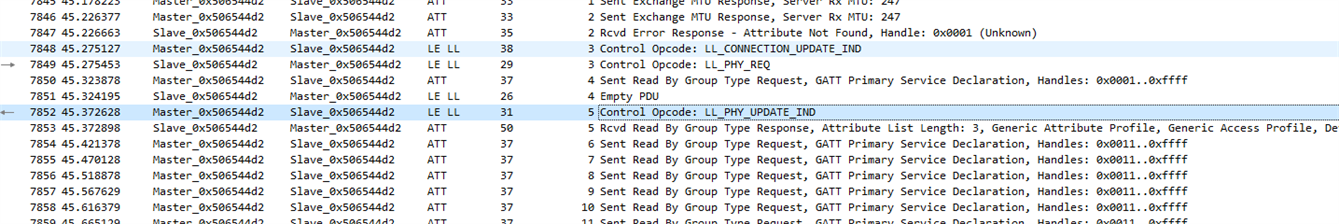

Our production device is having issues with the BLE connection only identified with the Samsung S20+ model currently. We are using custom services for our phone App to communicate with our device. What is happening is that the connection is dropped quickly after the initial configuration handshaking occurs between the phone and our device. I observe the MTU exchange happening, but then the connection is dropped.
Are there any known issues using the nRF52832 and the 1.9.1 BLE stack and specific Samsung phones?
Thanks for your help.
  • Hi Pamela,
    It's good that you managed to get the sniffer working.
    Our team is looking at a solution to make it work on DK v3.0.0
    Regarding the issue you are having with Samsung S20+. From what I can see is that the MTU exchange was performed without any problem. The nRF52 requested and got the response.
    However what I see is that the slave (nRF52) stopped responding after packet #7852. The master retried after that until timeout happened:
    It's hard to tell what happened without any log from the nRF52. Could you check if there is any log on the nRF52 ?
    It could be the issue either with the application or it could be the BLE stack that crashed.
    It's why I was asking if you observe the same issue on the stock example in the SDK. Could you please try to reproduce the issue on one of the example ? If it doesn't happen you may want to add what you added to your application for example MTU exchange.
    I have a Galaxy S10 and a Galaxy S22 here that can be used for testing. If you can provide any example to reproduce the issue it would be great.
