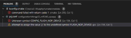

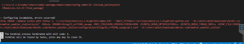

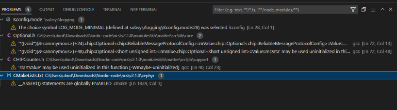

Hello, I recently acquired the thingy53 device and I am trying to use the example of the weather station with matter:
Weather Station
. I am following what the documentation tells me, in the construction part of the application, but every time I want to build it, the following error appears:
I'm not sure what they mean, since I'm not very familiar with the use of thingy 53,  except what I saw in the basic course, could you tell me what this could be due to?

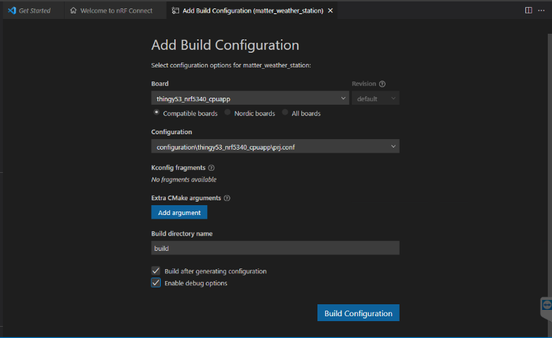

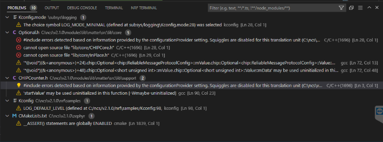

  • Hello, When I begin to build the app, I use this configuration:

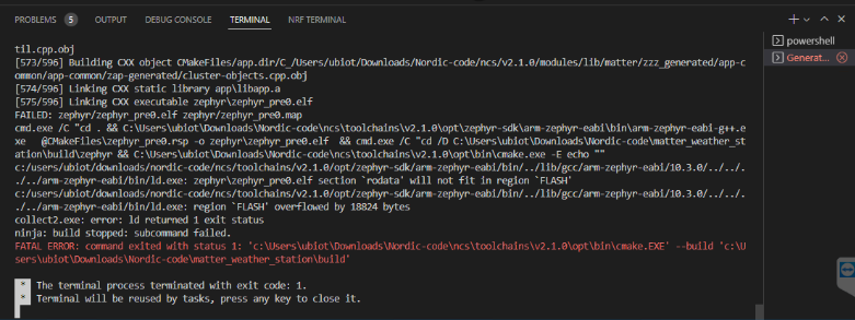

    When the code finish the build process this messages is appears:
    I
    i
    I
    Great that you were able to build the application.
    The application can be flashed to and run on your Thingy:53. You just won't be able to debug the application with debugging software. Logging is still available if you have it enabled in the prj.conf of the application.
    My suspicion in my previous reply has been confirmed. The application was too big for the Thingy:53 when the debug options were enabled. The Matter applications and samples are in general quite large, needing most of the available flash on the device. If you want to make your application smaller you can take a look at the Memory footprint optimization for Matter.
    Building the application with prj_release.conf instead of prj.conf will also make it possible to build with debug options enabled. So depending on your preferences you may consider that option if you want to debug with debugging software. Note that the Thingy:53 does not have an onboard debugger, and you would need an external debug probe to debug the flashed application with for example an nRF5340 DK.

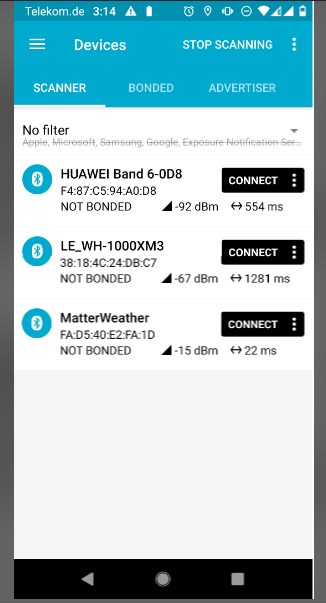

  • hanks for the help maria, try to pass the app to the thingy and the flash was done correctly, now I am currently facing the following problem:
    I am trying to use the chip tool via android, the documentation tells me that for this app the nrf tag is used as a way to commission the device, I saw a video of the nordic webinar, where they show how to make that connection that is just bringing the phone to the antenna of the thingy and wait for the pairing to start.
    However, I can't get that process to start, according to the documentation, when the app is transferred to the nordic it activates the viable provisioning for 15 min, so in that period of time it should be able to do it.
    when i use the nrf tool i am able to see the device so the ble is active, i can also see it via bluetooth. What can this be due to?
