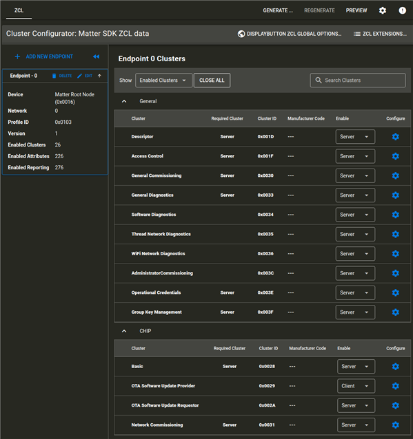

    When I run the zap tool endpoint 0 is automatically configured as Matter Root Node with all the same clusters as in my previous picture:
    The picture above is from when I created a new application in VS Code just as you did. I did not do anything else with the application before running the zap tool, so this is what my device looks like in your step 2. I asked a colleague of mine to test as well, and they got the same as me.
    I am looking into what the reason might be for why the Matter Root Node is not automatically configured for you, but I need some more time to investigate. Have you made any changes to the template sample previously? Did you install nRF Connect SDK using Toolchain Manager or manually? Can you also upload the output in the terminal from when you run the zap tool?

  • What happens if you save the template.zap file, quit the zap tool and reopen the template.zap file??
    But in your picture the number of enabled clusters is also wrong (you don't have 26 enabled cluster but only 15), isn't it?

    And a new created matter-template leads to this view in zap tool
    If I save, close, and reopen it then it looks the same. Same amount of clusters and everything.
    When comparing your output with mine I see that you get errors about reading xml files, due to unknown extension files. Did you install nRF Connect SDK manually or using Toolchain Manager? If you installed it manually, did you make sure to install all python requirements?

  • Hi
    I removed my SDK v2.1.0 with the Toolchain Manager (and manually, because the Toolchain Manager times out ("Removing ... ") and moved some files to an new Directory "toBeDeleted").
    After the clearing I reinstall the SDK v2.1.0 and rebuild the zap tool with following tweaks:
    - nvm v0.39.1
    - node v18.11.0
    - npm v8.19.2
    1.) cd to /opt/nordic/ncs/v2.1.0/modules/lib/matter/
    2.) bootstrap the zap tool with ./scripts/tools/zap/run_zaptool.sh
    --> Error occurs due to an openSSL issue
      opensslErrorStack: [ 'error:03000086:digital envelope routines::initialization error' ],
      library: 'digital envelope routines',
      reason: 'unsupported',
      code: 'ERR_OSSL_EVP_UNSUPPORTED'
    2.1) Fix the error by setting an environment variable
    export NODE_OPTIONS=--openssl-legacy-provider
    2.2) (again) bootstrap the zap tool with ./scripts/tools/zap/run_zaptool.sh
    --> zap tool will be compiled but cannot be started because of the openssl-legacy-provider option (set before in NODE_OPTIONS)
    ⇝ electron: --openssl-legacy-provider is not allowed in NODE_OPTIONS
    2.3) export NODE_OPTIONS=
    3.) (again) bootstrap the zap tool with ./scripts/tools/zap/run_zaptool.sh
    --> zap tool is compiled and will be started and crashes because of an (arm64) sqlite3 issue
    3.1) cd to /opt/nordic/ncs/v2.1.0/modules/lib/matter/third_party/zap/repo
    3.2) npm uninstall sqlite3
    3.3) npm install sqlite3 --build-from-source --target_arch=arm64 --fallback-to-build
    3.4) cd to /opt/nordic/ncs/v2.1.0/modules/lib/matter/
    4.) (again) bootstrap the zap tool with ./scripts/tools/zap/run_zaptool.sh

    5.) Be happy about a working zap - tool Slight smile
