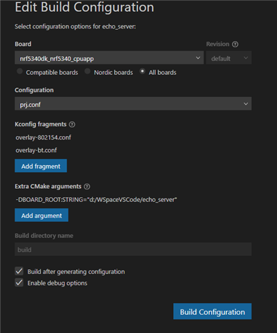

I have two nrF5340 DKs for the client I've built it with the overlay-802154.conf, for the server I have built it with the overlay-802154.conf and overlay-bt.conf
The server runs on it's own, but when the client is switched on it crashes:

    I am not able to reproduce the error you get. When I try performing the same steps as you I get "Network disconnected" instead of "Waiting network to be connected", but it does not fail afterwards.. How do you add overlay-802154.conf and overlay-bt.conf? Which version of nRF5340 DK do you have? You should find the version on the sticker on the DK, the line under "PCA10095".

  • Hi Marte,
    I have 2.0.0 as the next line.
    I add the overlays by using the "Add fragment" button:
    Richard
  • Hi Richard,
    I am still not able to get it to crash. I have the same DK version as you, and added the overlays in the same way. Now I see "Waiting network to be connected", but no crash. Are you debugging while this happens? Can you check what the callstack is?
