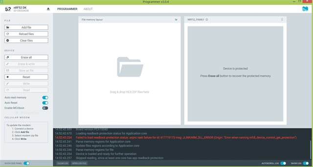

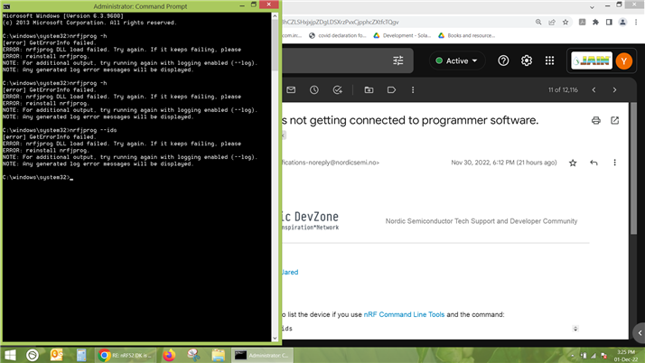

nRF52 DK is not getting connected to programmer software.
I have installed nRF connect for desktop .In which I am trying to connect nRF 52 DK through programmer software. As soon as I connect the development kit via USB to type B cable to laptop, it shows J link. But it does not show nRF52DK. and programmer software shows unsupported device. How could  I resolve the issue.

  • I have arrange Window 10 Pro system and installed nRF connect for desktop and tried to load the hex file.
    But still I am facing the same issue.

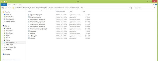

    If we connect the tag connect connector to Dev Kit and SWITCHED it ON ,programmer software device list shows JLink.
    And if we remove the tag connect connector from Dev Kit and SWITCHED it ON, the programmer software device list shows nRF52DK.
    And the command nrfjprog is directly executed.

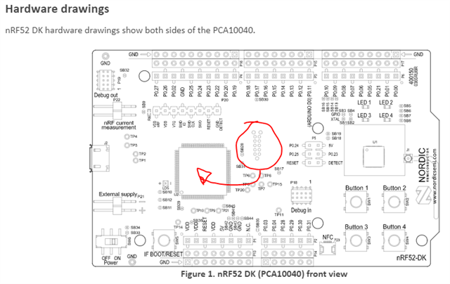

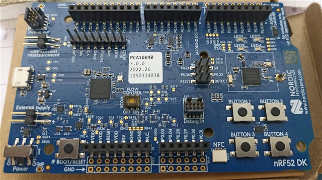

  • The tag connector on the DK is for programming the debugging chip on the DK itself, so I don't think we need to explore that route.
    In order to program the DK you can use the usb, and if you want to use the DK to program you Minew board you can either use SWD or the 10pin Jtag debug port. I think you will prefer the latter.

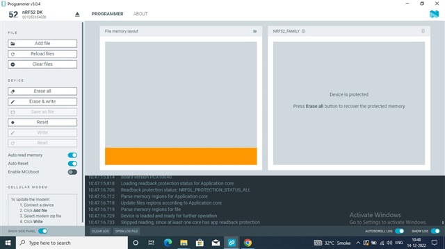

    If I keep the DK turned ON and disconnect the tag connector then nothing happen but if I select the Jlink device,the name gets changed to nRF52DK and log shows unsupported device.

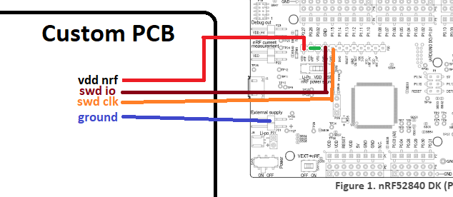

    After looking a bit at a Minew chip overview, it looks like you might have to use SWD.

  • Yogesh Sarode said:
    The tag-connect connector follows the ARM Cortex connector layout that is also used by NRF on the nRF52-DK.
    I see, I just wanted to make sure that you are not referring to the connectors which I've circled in the illustration below, they are routed to program the interface chip of the DK. As long as you use the debug out port on DK you should be fine. Or alternatively you could use the other setup I've outlined below.

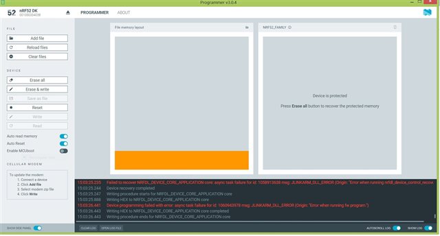

    So with the Debug Out port connected to the Minew chip, and the DK powered on, how is it looking in the nRF Programmer?
