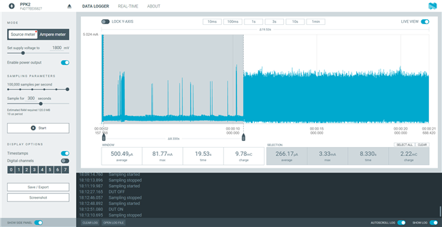

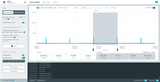

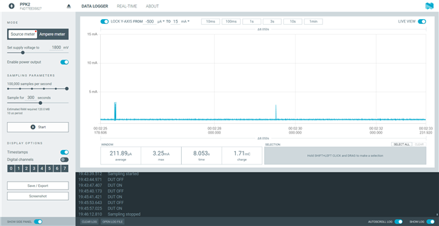

Hello All,
I am getting these ~3.5mA current spikes very 4 seconds and I can't seem to figure what the cause of them is. some of the spikes have a single spike/pulse while other have multiple. please see the attached images. I have commented out everything except the while in the main function and no difference. I have also commented out the enabling of the DCDC and still the same issue. any help would be greatly appreciate. I have a feeling its in the project config setting but tried commenting out what I thought may be the cause but no change either.
I am using a custom board with 52833 and nRF Connect SDK 2.0.0. the board does have other ICs(hall sensors) but I measured their consumption and had no spikes.

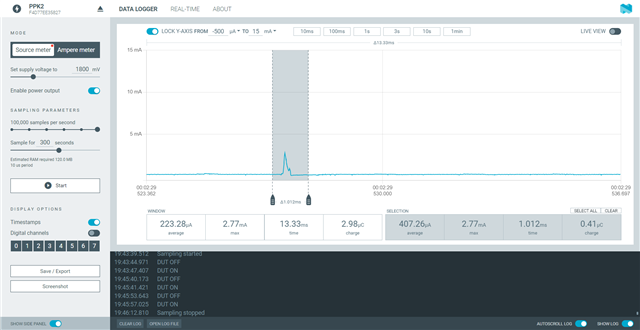

    Please set CONFIG_CLOCK_CONTROL_NRF_CALIBRATION_MAX_SKIP=0 and then try to adjust the  CONFIG_CLOCK_CONTROL_NRF_CALIBRATION_PERIOD setting to see if it affects the interval of your current spike. The 2nd screenshot looks could be showing the clock calibration event (The 32K RC oscillator is calibrated periodically against the HF crystal oscillator).
    Vidar
  • Hi Vidar,
    That seems to be it. I set the following
    CONFIG_CLOCK_CONTROL_NRF_CALIBRATION_PERIOD=2000
    and period did change accordingly. please see plot.
    So with that said, I have few questions.

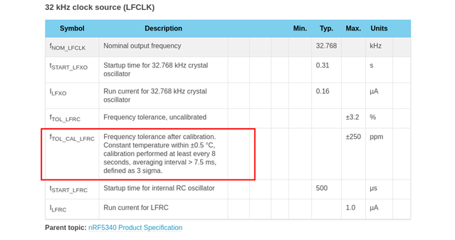

    1) will an external 32kHz crystal use less power? or
    2) Since we know our device will be operating in a fairly temp controlled environment, what do you think would be wise settings to minimize power consumption but not get some egregious clock drift?
    for example, do the cal every x number of deg change if possible. what do you think that x should be
    or do it every x seconds(what do you think that x should be)
    your help is greatly appreciated.
